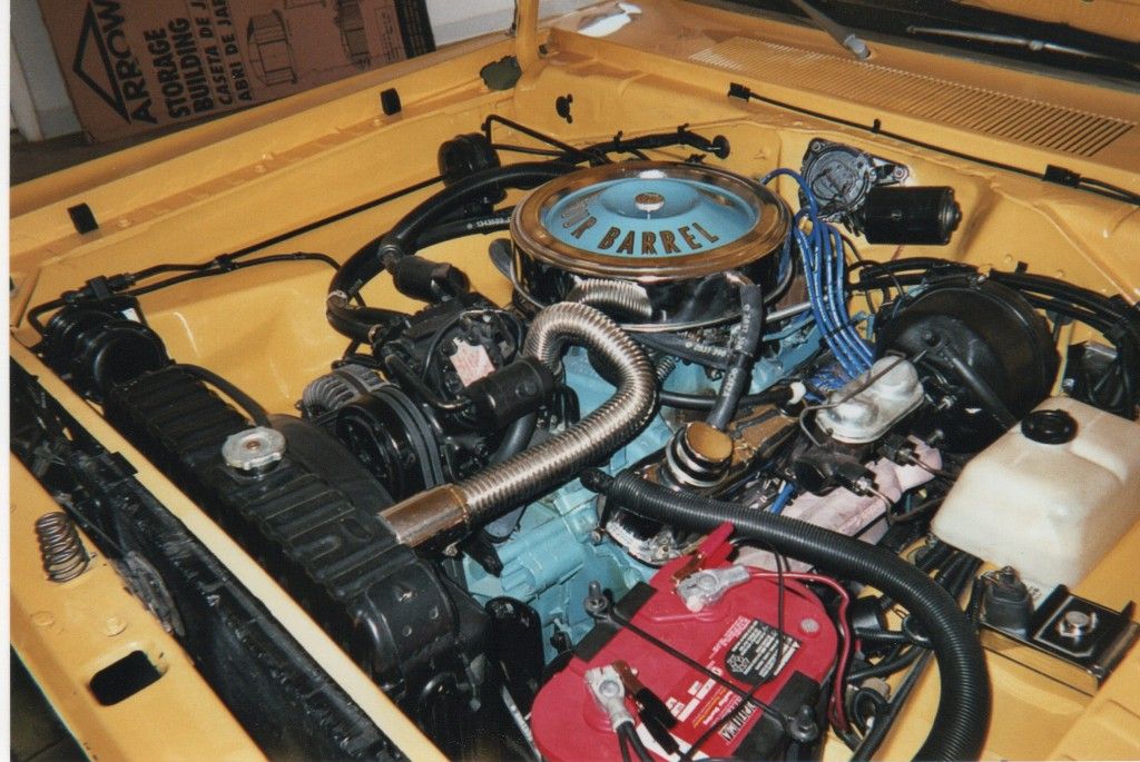

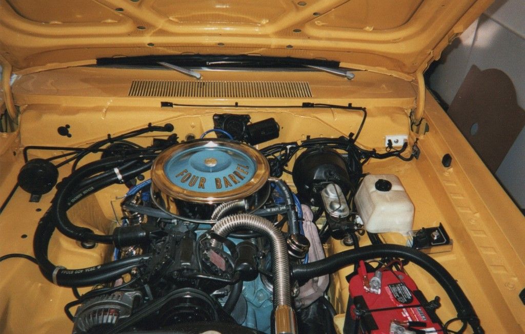

As far as what M&H can do for you goes, they are able to manufacture wiring harnesses for any body style and can make anything from a custom harness to an exact factory reproduction harness as long as you can communicate to them exactly what your needs are for your application. The M&H harness that I purchased for my sons 1972 Dart Swinger through Year One was modified by M&H to handle a Mopar Performance electronic ignition conversion kit that I had installed on the car and the harness fits the car perfectly and looks like it came from the factory that way, so I was very pleased.
I'll post a picture of my sons Dart engine compartment below, but you won't be able to see the actual wiring harness because I enclose all of the wiring on the Dart and my Coronet in plastic automotive tubing to protect it from direct heat sources and other contaminates.
