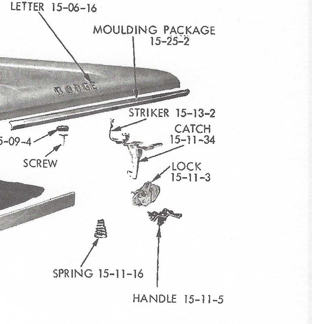

Hello Smoke,
I'm not suppose to post any information directly from any of the Chrysler Factory Parts Books, including the 1967 Chrysler Factory Parts Book that I have due to possible copyright infringement issues, but below is a small portion of one of the factory diagrams that shows all of the 1967 Coronet hood latch and lock assembly parts so that you can verify which parts you might need to replace on your 1967 Coronet 500. If you need factory part numbers for any of these parts that you're missing, or that are damaged, just let me know and I will post them for you.
[Image: 1967%20FPB%20-%201967%20Dodge%20Coronet%...g~original]
