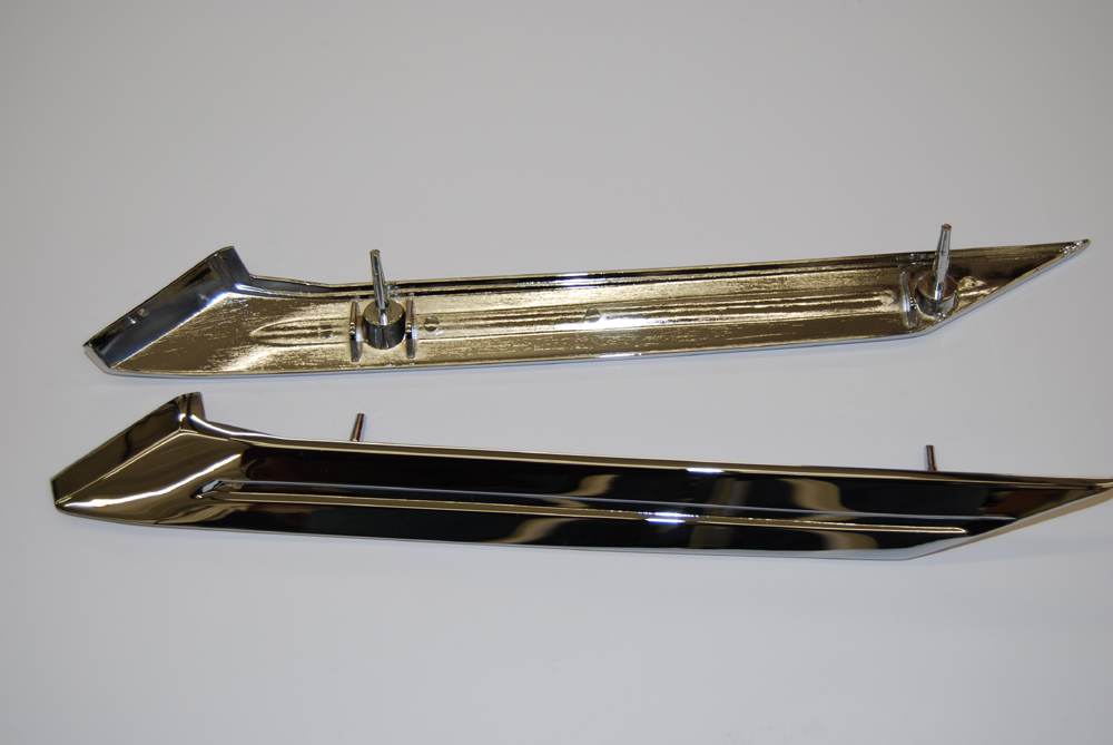

Below are some pictures of the reproduction trim as well as pictures of my 1966 Coronet 500 while it was being repainted back in 1990 that show the two mounting holes for this trim as well as my cars original trim wher it belongs. I don't have exact measurements on where those two trim mounting holes are located on both sides of the roof, but if you have the chrome trim you can measure the distance between the two mounting pin studs and figure it out.

[Image: 116-66.jpg]
[Image: My%201966%20Coronet%20500%20-%20during%2...g~original]
[Image: 1966Coronet500-rooftoquarterpaneltrim1-s...g~original]
[Image: 1966Coronet500-rooftoquarterpaneltrim2-r...g~original]
[Image: 1966Coronet500-rooftoquarterpaneltrim4-r...g~original]

Thanks Richard, those pictures are going to help a lot. I did find a good set that are much better than what I had. From those pics I can figure out where to drill the holes for the pins. Much appreciated, Ken
You're very welcome Ken. If you would have ask this question back in 1990 I could have given you the exact mounting hole measurements as well! Rofl Also remember to measure the hole locations two hundred times and drill the holes once! Wink
