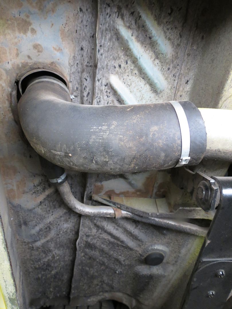

Here are some older pictures of my 1966 Coronet 500 2 door hardtop before I replaced these rubber elbow hoses a couple of years ago and they are the same as those used on your 1967 Coronet.
Main Fuel Filler Tube To Fuel Tank:
[Image: 1966Coronetfueltankfillertubeandfillertu...g~original]
[Image: 1966Coronetfueltankandrelatedparts.jpg~original]
[Image: 1966Coronetfueltankandfillertubehose1-1.jpg~original]
[Image: 1966Coronetfueltankfillertubeintofueltan...g~original]

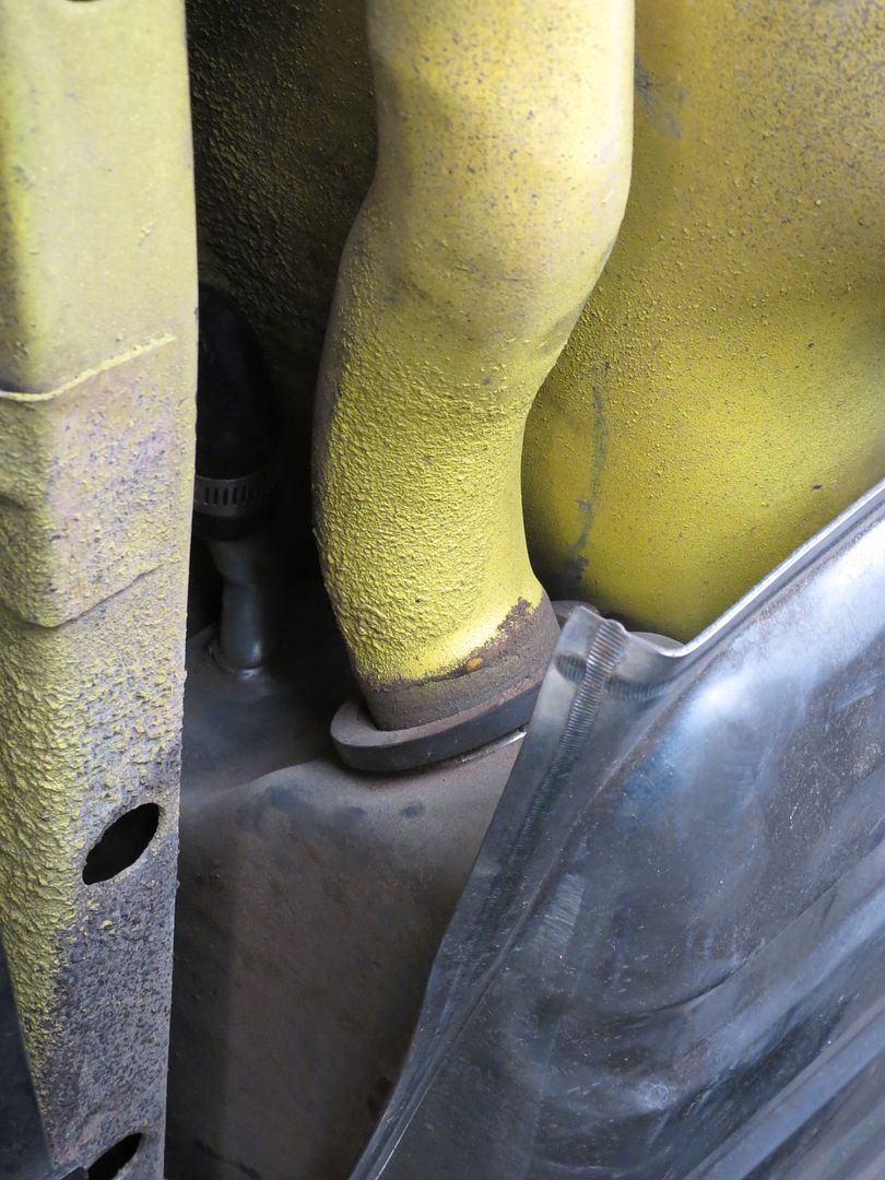

Fuel Tank Vent Tube:

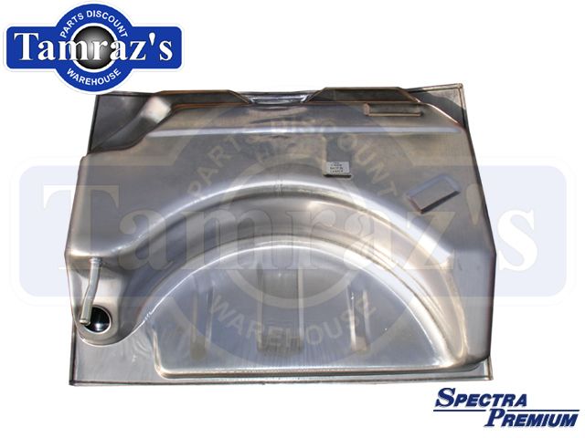

Picture Of The 1966 & 1967 Coronet Fuel Tank Showing Main Fuel Filler Tube & Vent Tube Inlet Locations On Fuel Tank:
[Image: SpectraPremiumCR14FuelTank3-1966Coronet.jpg~original]

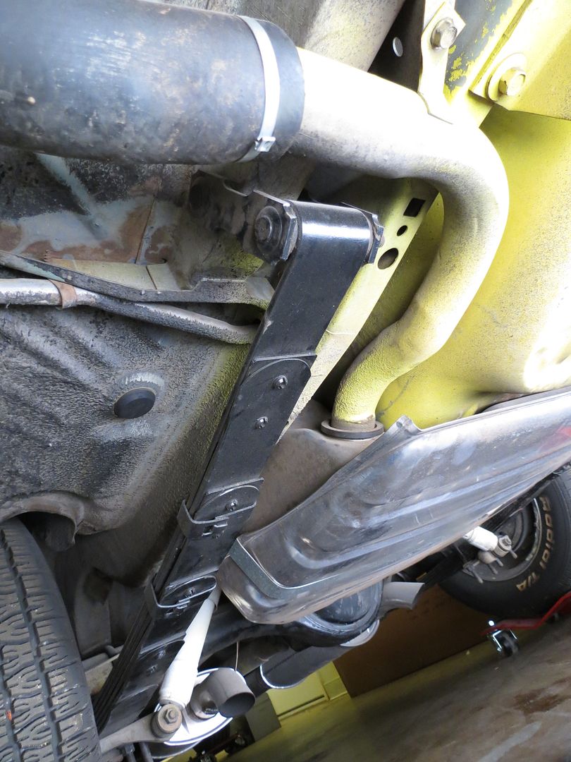

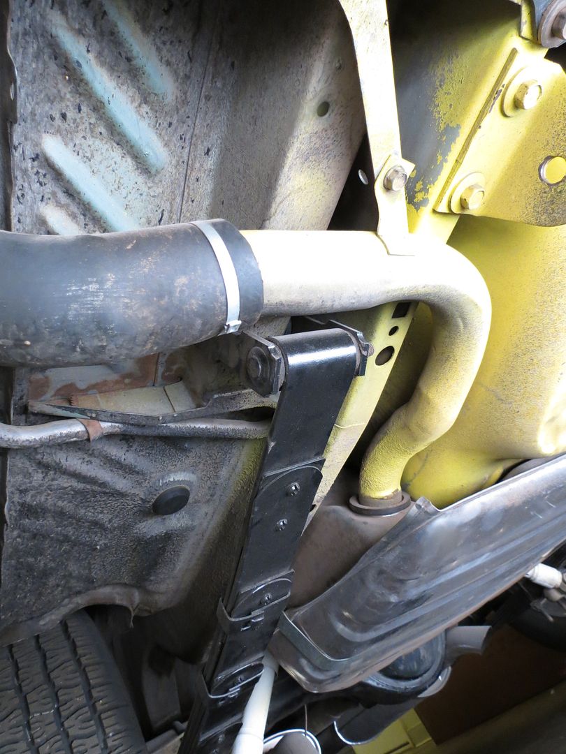

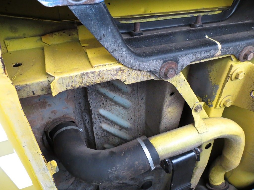

Sorry about the darkness, I toke 5-6 pics under there, but they still came out dark, even had the droplight there.
7770]7771]7772]
Ok look at what I'm dealing with. Is the line bent wrong or is it tweaked that bad from shipping/storage?
I can't pull the line towards the tank because of the shock mount being in the way.
