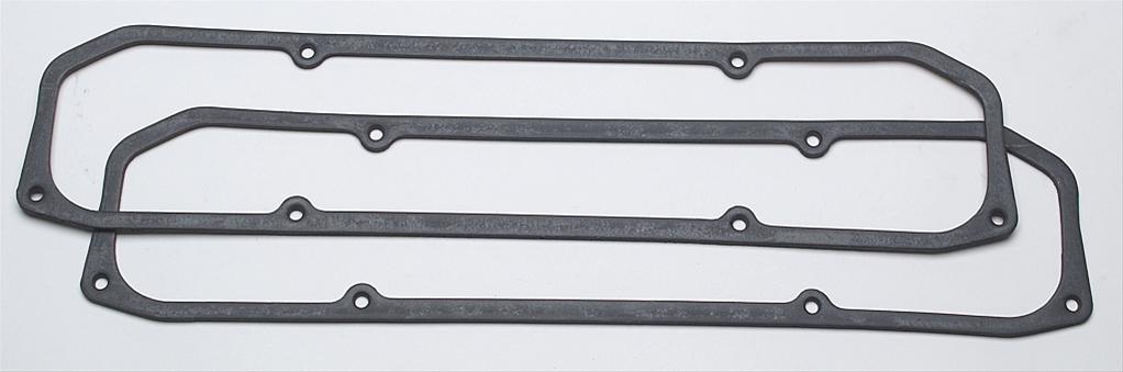

Richard, out of curiosity, what kind of gaskets are you using. I've been using felpro rubber, but I was wondering if they have come up with something better in the last 13 or so years since I've done one.

http://chucker54.stores.yahoo.net/mopestcovaco.html
These and M/T aluminum covers on my truck 383 no leaks. I imagine these will work real good with aluminum heads since they have a nice seal surface. R/T has stock chrome covers with cork and it I get a couple drips by the time you do an oil change(3000) but not much plus the engine is old so it has some blow so that pretty good. Think I will get another set of these next time I remove the covers.

ws27 Wrote:Richard, out of curiosity, what kind of gaskets are you using. I've been using felpro rubber, but I was wondering if they have come up with something better in the last 13 or so years since I've done one. Hello Rich, Like you, I haven't had to purchase valve cover gaskets for quite awhile, but the ones that I'm using on my 440 have worked well and are still available under Mopar Performance part #P4452091 and are a rubber reinforced cork design. They are listed in the latest Mopar Performance Parts Catalog as being for use with cast valve covers, but as I can vouch for, they also work very well with stamped steel valve covers as well. To avoid potential valve cover leaking issues, when I had all of the machine work done on my 1969 hp 440 for my Coronet back in 1990/1991, I had the machine shop check all of the engine block and cylinder head's mating surfaces to make sure that all were flat and true and that included the mating surfaces on the cylinder heads where the valve covers are attached and I'd highly recommend that anybody that is rebuilding their engine do the same thing if they plan on using any of the original factory cast iron Mopar cylinder heads. If I needed to purchase valve cover gaskets these days, I'd go with another set of the same gaskets that I've been using for years without issues (P4452091), or I might try a set of the Mopar Performance part #P5155509, which are listed as being a "reusable" design and are probably very similar to the ones in Andy's link. I might also try a set of the Fel-Pro's if they were offered at the same price that I can get the Mopar Performances gaskets for from my friend at a local Dodge dealership, as being a member of the "cheap bastards club", I try to avoid pay retail prices for any of my parts if at all possible! .Here's a picture of the Mopar Performance part #P4452091 gaskets. ![]() Richard

Those look just like the fel-pro. Thicker rubber coated reusable

Hibbing_Coronet_500 Wrote:Those look just like the fel-pro. Thicker rubber coated reusableI agree here. Thanks Richard. It would be nice if someone would come out with a silicone gasket. That would guarantee to leaks.
