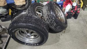

I found some wheels that might look cool on Junior. I just feel like a change from the caps. They were on a `70 Challenger that was sitting for a long time so they are very dirty but the chrome looks very nice when wiped off. Scrub a Dub time.
US wheel  here we go.

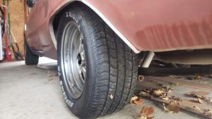

There going to clear just barely....perfect!!
225/60×14 . Front also just clears control arm.
14×7 wheel
that's about the clearance you get with 255/60/15 on 66/7 Coronet..
