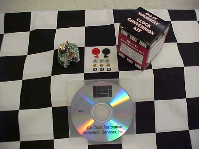

harold prentice Wrote:Well, I've been a bit nervous about pulling the clock out of my '66 Coronet but it was a slow day, so..... Anyway, no big deal (thanks shop manual!) and in pretty short time, I had the instrument cluster out on the bench. Interesting point, the power wire from the Ammeter post to the clock was disconnected & taped up.....hmmmmmm. Took the clock out, disassembled the case, hands off, etc and realized it's really a normal wind up clock with an electric winder. Check that the contact points were ok and tested that the rewind solenoid worked - looks like the clock mechanism is gummed up. I decided to try a local clock/watch repair guy, who has years of experience, and he knew exactly what I had and how to service it. Should be ready in about a week. Of course, he did have to tell me that clocks from that era were pretty much junk when new & only lasted about a year - already knew that! While I was at it, I 32293230323132323233cleaned the bezel glass and the instrument faces, also a good time to replace burnt out bulbs. I'll let you know how this turns out in a week or so. Did I ever mention to you that there are quartz movement conversion kits available for our 1966-67 Coronet factory dash mounted clocks? This kit comes with an instructional DVD as well as written instructions, but I'm sure that your local clock repair shop that you mentioned could do this conversion for you if you don't want to do it yourself at home. Since you already have the clock out of the car, now would be the perfect time to do a conversion like this. The ebay seller mentions a one year warranty, but that's a basic electrical part warranty and I'd bet that it will last much longer and at least your clock would draw less current and would keep much better time. Richard Ebay link: http://www.ebay.com/itm/Quartz-Conversio...3a86ad4fe8
