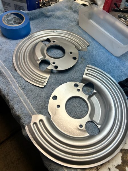

Splash shields clean  -
[Image: img_1918-jpg.1942219]
#46
Those look nice, usually all bent to crap.
#47
I had to do a little straigtening on them. - Andy, you mentioned checking for cracks in the K-member can you explain to me where I should check it?

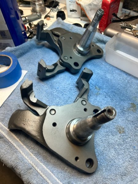

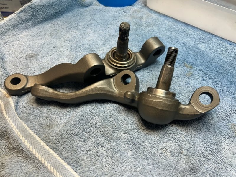

Getting closer -
Spindles & lower ball joints painted Eastwood cast iron grey. The splash shields are painted Duplicolor cast aluminum.
