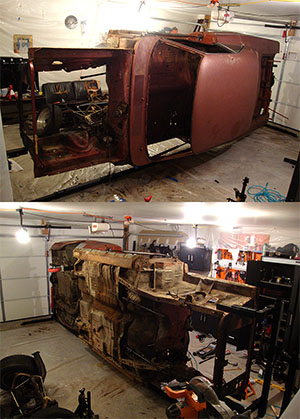

I put the car on rotisserie (which I also fit into my altima) in my home to work on it. Here you can see the car on the rotisserie in my garage. Scary by yourself but it is possible!
[Image: rotsmall.jpg]
