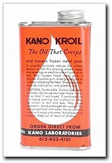

67r/t4speeder Wrote:Thats a bummer I have been there done that. WD-40 is not a very good penetrate though, PB blaster would be better. The drum and axle have become one Sad
I have heard This works like magic with some heat, I have not tried it since I dont have any....yet .[Image: 41CV94FBDZL.jpg]
#28
Kroil is good stuff. You can also use a 50/50 mix of acetone and ATF, but be warned you do not want to introduce any heat to this mix.
