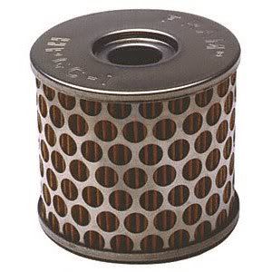

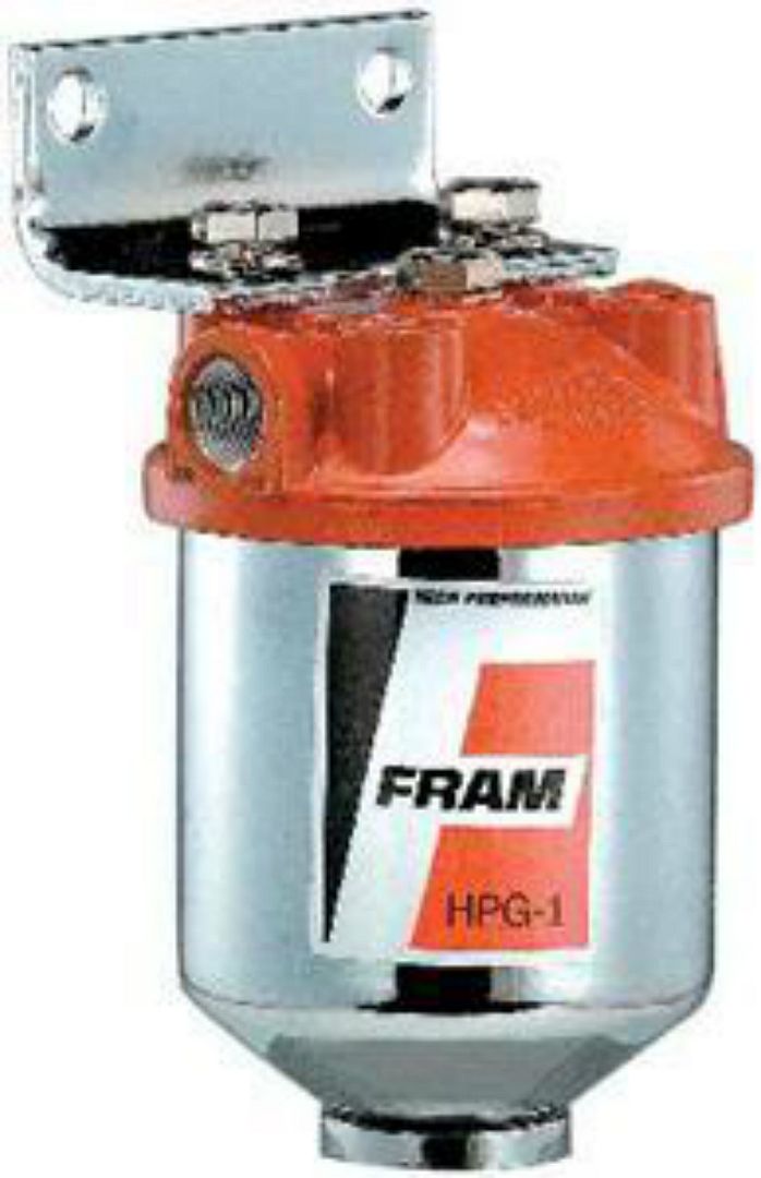

To help keep contaminates out of that fuel pump, I also run one of the heavy duty Fram HPG-1 in-line fuel filters shown below. It is mounted towards the back of the car not far from the stock fuel tank. These Fram filters are easily found at many different outlets on-line and don't forget to purchase a spare filter element as well.
