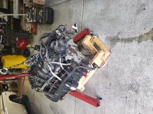

A few months ago I bought this 2012 5.7, it was in a ram truck and had a miss on number 1 cylinder. Got it for $340. I had a pretty good idea it was going to be a wiped cam.
After tearing it down I wasn't surprised at what I found

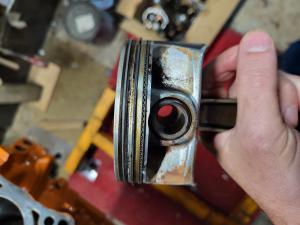

Having only ever worked on vintage mopar motors, some of the stuff inside is a little different- fractured connecting rods, they use a bolt but no nut. The pistons are very short with thin rings
Light weight parts

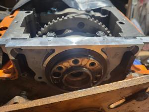

One piece rear main seal, what a great design
