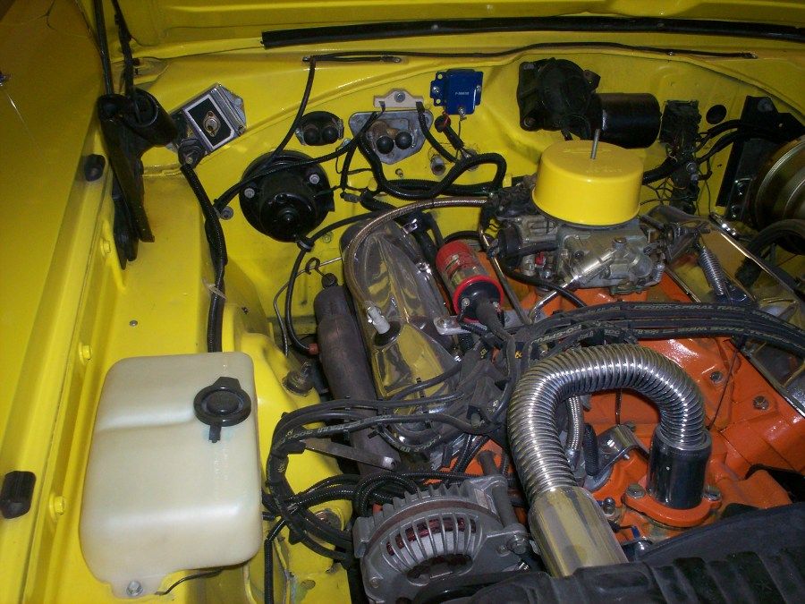

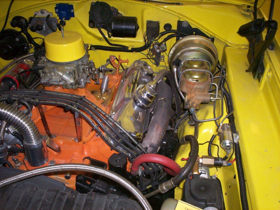

A couple of older pictures of my '66 Coronet 500's engine compartment that show the clearance between the inner fender sheet metal and the H.P. exhaust manifolds on both sides of the engine compartment. These manifolds also don't care if you're running a 4 speed or an automatic transmission either, as these manifolds will clear all of the front suspension, steering and transmission parts just as Chrysler designed them to do.
