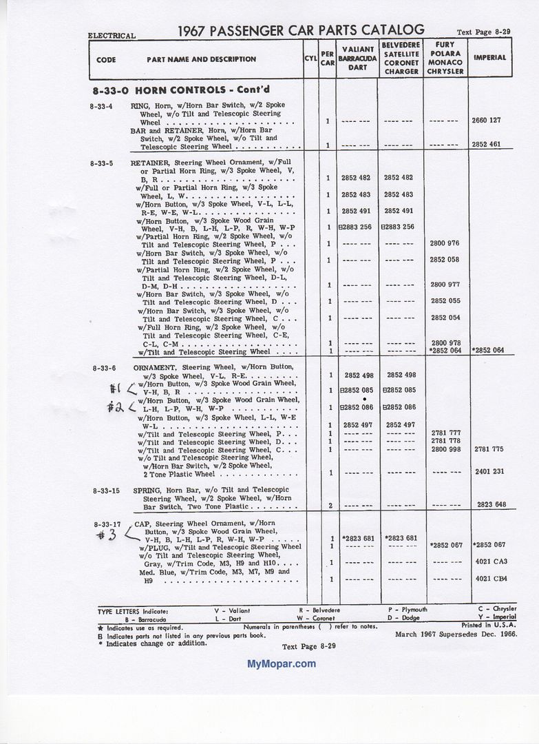

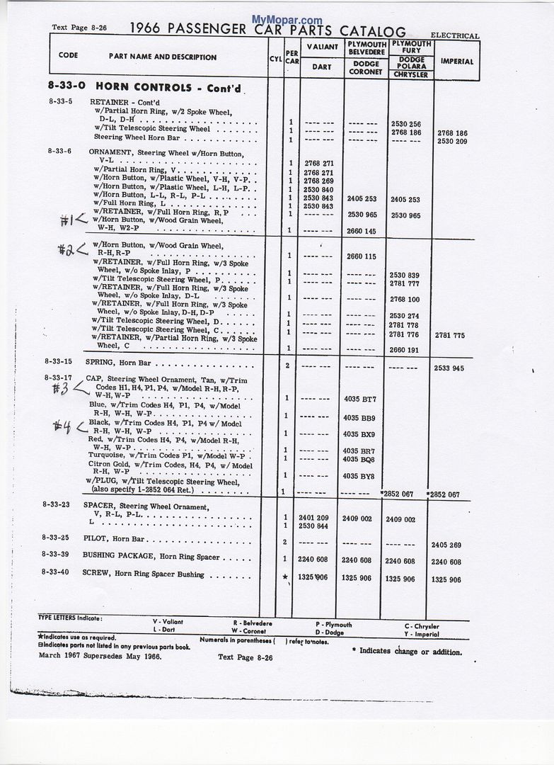

Ok, here are all of the part numbers listed for the 1966 and 1967 horn controls and I've marked each listing for the wood grain steering wheel related parts. Part number 2660114 is not shown, so I'm not sure why and I also checked in the interior trim section and the numerical part number listings in the back of each model years part book and did not find this part number in those sections either, so maybe someone else can let us know why these various horn button part numbers on your guy's two wood grain steering wheels are not listed along with the wood grain steering wheels in the factory parts books.
1966 Horn Controls:
[Image: 1966FPB-HornControls.jpg]
1967 Horn Controls:
[Image: 1967FPB-HornControls.jpg]
