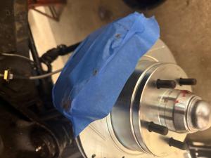

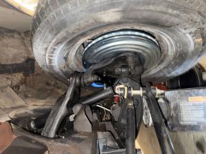

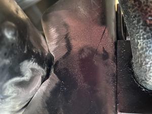

(09-12-25, 05:49 PM)theman440 Wrote: I need some opinions here, I bought these ball joints a while ago and just now got around to comparing them to the old ones. Check out the dome on top of the ball joint, the old one is flat. I dont think I've ever seen that before. They are identical except for that, my question is . . . do you think I will have intererence issues with the tire or rim?
With 14" spare that clears the 10.95" rotors
If you ever wonder where a 14" rim will hit on a 11.75 rotor setup and Wilwoods, here ya go.

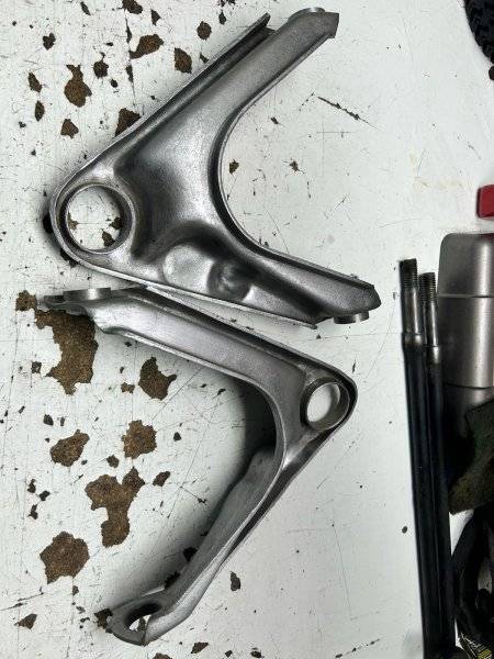

Upper control arms ready for new bushings, ball joints & the proper color paint!
