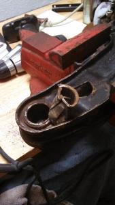

Weldin is cheatin.. ya gotta beat em out like they were meant to be beaten...

(09-05-25, 10:49 PM)67440Dodge Wrote: Weldin is cheatin.. ya gotta beat em out like they were meant to be beaten...
Geeze Mike I recommend you go back to anger management classes.
RE: Rear-end Re-fresh - 67440Dodge - 09-07-25
(09-06-25, 06:49 PM)67r/t4speeder Wrote: Geeze Mike I recommend you go back to anger management classes.
I am taking them.. I didn't throw the brake rotor across the garage when the bearing race didn't fit like I normally would!!
RE: Rear-end Re-fresh - theman440 - 09-08-25
Mike,
That was the method previously used to remove them. I have done it that was before but this time I wanted to use a little less brutality. It always creates more work.
RE: Rear-end Re-fresh - 67440Dodge - 09-08-25
Was kidding Jeff.. if I had a big enough vice/press, I'd have done same, lot less aggravation

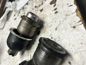

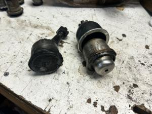

I need some opinions here, I bought these ball joints a while ago and just now got around to comparing them to the old ones. Check out the dome on top of the ball joint, the old one is flat. I dont think I've ever seen that before. They are identical except for that, my question is . . . do you think I will have intererence issues with the tire or rim?

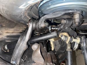

(09-12-25, 05:49 PM)theman440 Wrote: I need some opinions here, I bought these ball joints a while ago and just now got around to comparing them to the old ones. Check out the dome on top of the ball joint, the old one is flat. I dont think I've ever seen that before. They are identical except for that, my question is . . . do you think I will have intererence issues with the tire or rim?
Gonna depend on rim size, tire size and backspacing..  this is a 255/60/15 on a 15X7 rim with 4 1/2' BS.  Suspension is compressed but even with that big tire on front looks like it should fit.
RE: Rear-end Re-fresh - theman440 - 09-12-25
The car has 14x7's with 245/60's on it. Dont know about the offset. I'guess 4.25

My brain would say red flag flying those ball joints are universal.
I would not use them.
I bought some Moog ones on sale recently if you need them. I just bought for back up.
