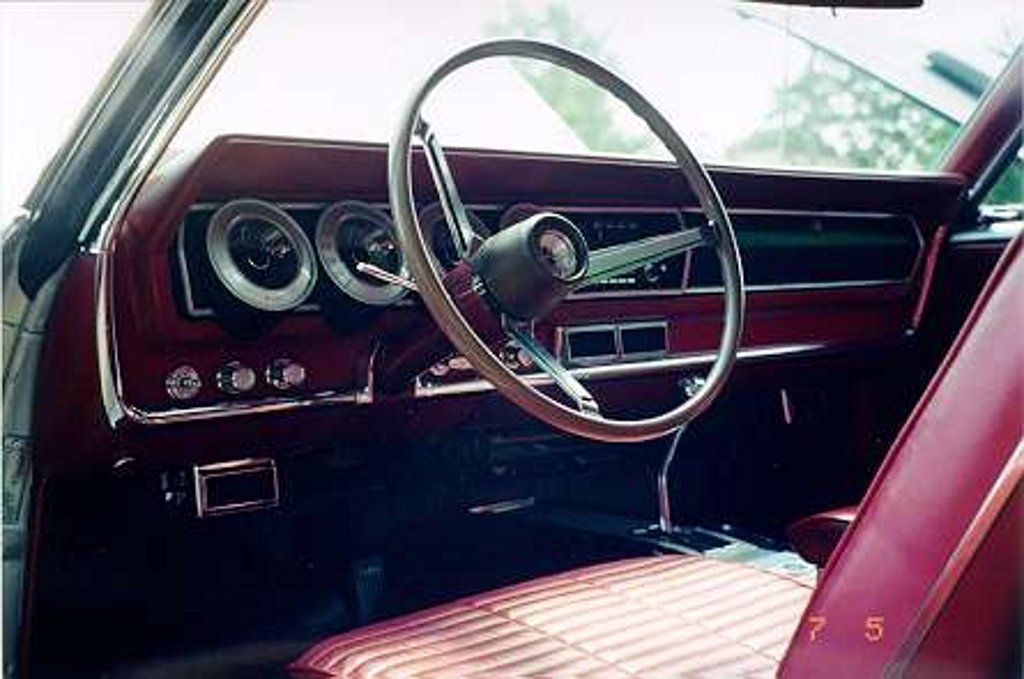

1966 Charger dash
[Image: 1966DodgeCharger-Redinterior-dashboardwi...g~original]

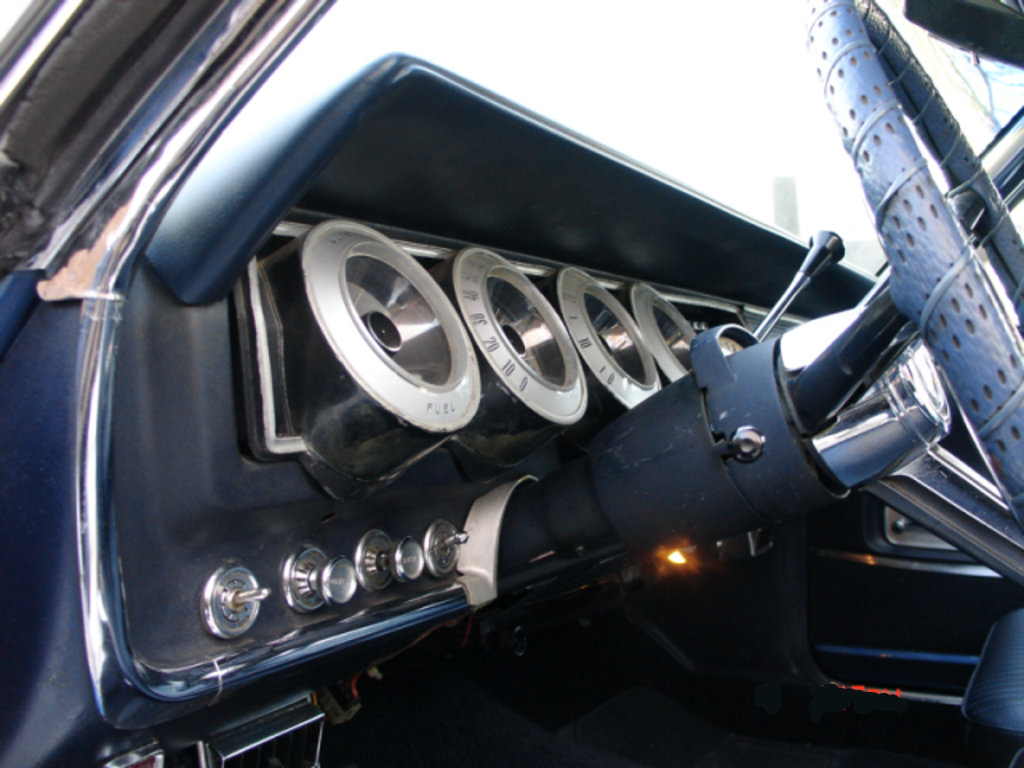

And the slightly different 1967 Charger dash
[Image: 1967Chargerdashboardassemblyincar-blacka...g~original]
