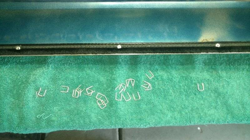

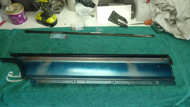

The rear windows havent been rolled down in years and they were stuck. I like to brag that "everything" works on this car so I got to work fixin it. The cat whiskers are original so I am replacing them along with the roof rail weather strip. All the window needed was lubrication and adjustment, The inner whiskers for the quarter windows are stapled on - no way that's gonna happen so I riveted then on.
[Image: img_20190707_160938022-jpg.805516]
[Image: img_20190707_171907794-jpg.805515]
[Image: img_20190707_171928699-jpg.805517]
The outer whisker was a bitch because the clip holes were in the wrong places and the lip was buggered up, but I got it on. Sorry no pics.
