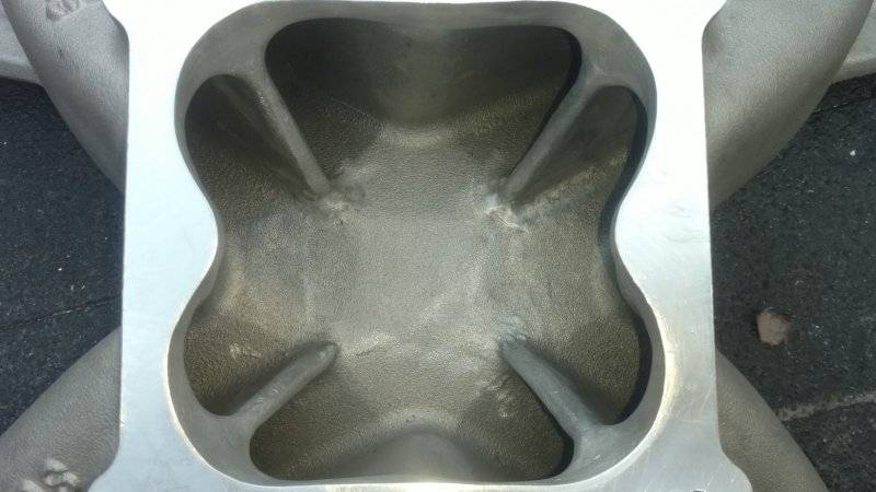

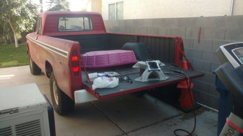

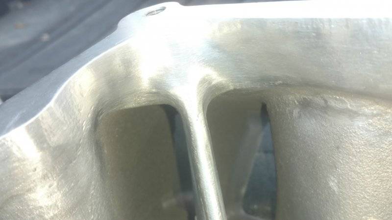

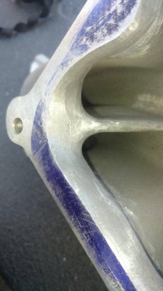

Time to finish up the intake -
Set up the work bench
[Image: img_20210905_162230246-jpg.1166137]
Getting started
[Image: img_20210901_183626015-jpg.1166138]
[Image: img_20210905_162706425-1-jpg.1166139]
[Image: img_20210905_182253700-jpg.1166140]
This is my first time doing this - I'm happy with the results.
[Image: img_20210905_182315074-1-jpg.1166141]

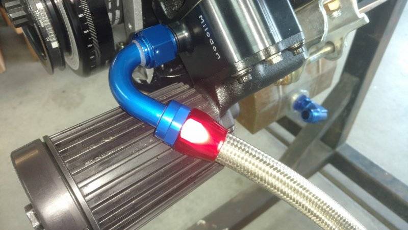

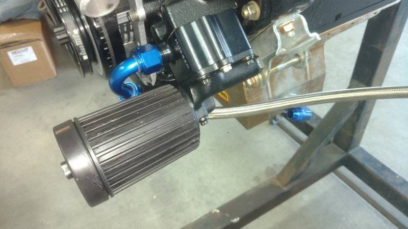

Bolt on pan, oil pump and left motor mount assembly to try to figure out how to route the oil pickup line. I'm finding this is not easy when you're using the stock type mounts and a stock K-member. It was compounded by the System 1 oil filter I want to use, it's too big (diameter) and interferes with the oil pickup line routing. I'm gonna have to do something else.
[Image: img_20210910_173424525-jpg.1166157]
[Image: img_20210910_173508403-jpg.1166158]

That intake looks just fine!
I would would not sweat the intake port alignment too much. On my Muscle Motors 528, the port alignment was terrible. I mean terrible. When I asked Mike Ware about it, he shrugged his shoulders and said don't matter, but if it makes you feel better here is some epoxy and go at it. So I did. Alignment was spot one when I was done. Zero et or mph difference. Zero. Go figure. All I can think of is that its laminar flow and the protrusions were not affecting the laminar characteristics.
Actually the manifold fits really good - all the port walls line up nicely. After I bolt the heads on with the gaskets I'll check the roof and floor alignment. I realize it wont be perfect but I'll get it as close as possible.
