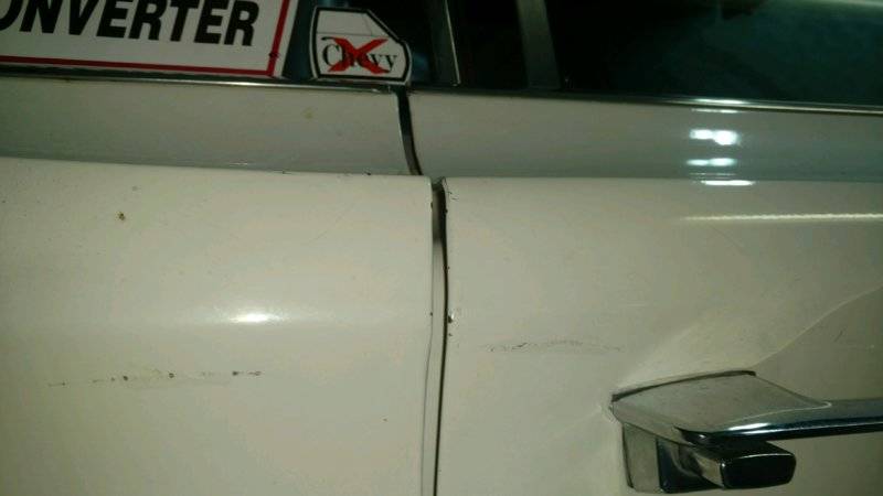

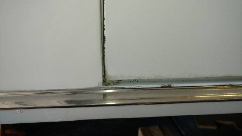

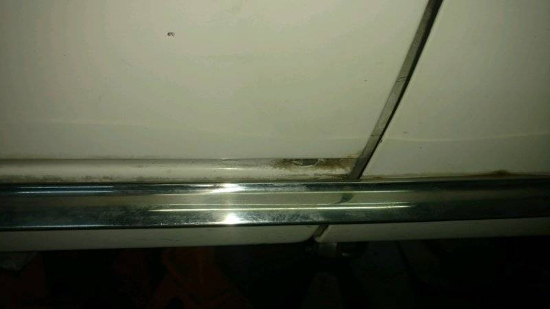

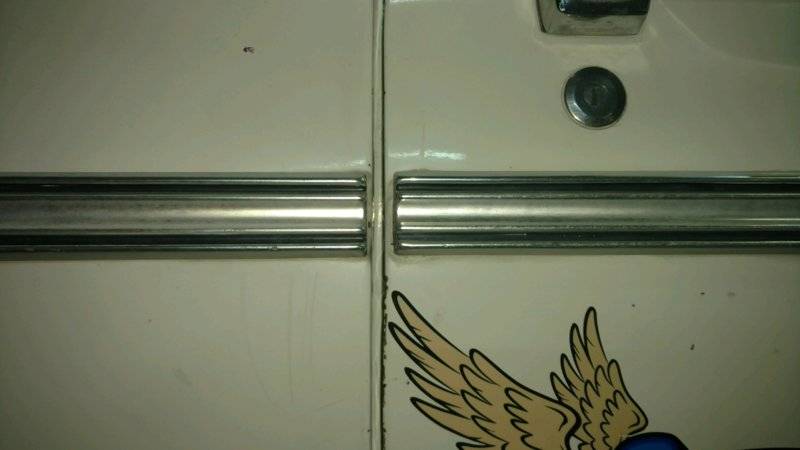

I'm gonna replace the door glass channel slides too (original) as well as lube up the window mechanisms. The passenger door wasn't aligned very good from the factory so I decided to adjust it while I'm doing all this work with the windows and seals. It was low in the front, high in the rear and too far in on the bottom. Hard to tell from the pics -

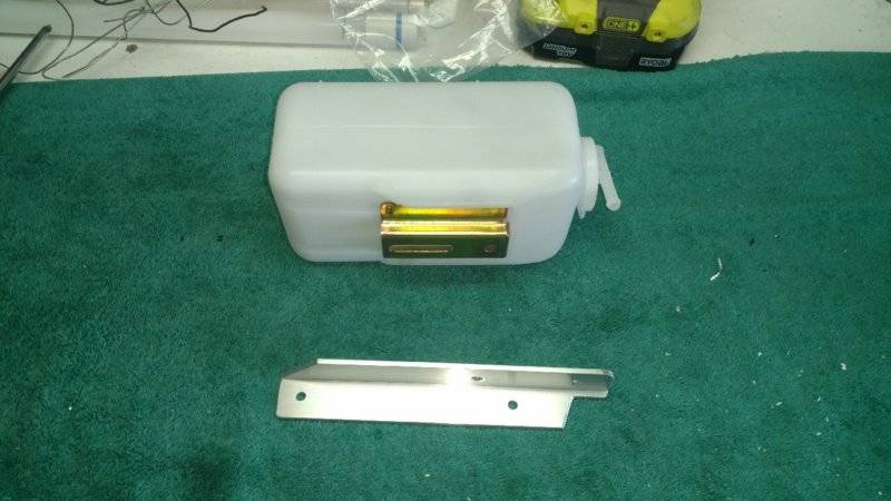

On the previous engine I used a Moroso water pump drive which also turned the fan. It worked well but this time I'm gonna go with an electric fan. I settled on this 12in dual fan set up in an aluminum shroud. I will keep the Moroso w/p drive to turn the pump.
New overflow bottle and fabricated bracket.
![[Image: img_20190721_122932835-jpg.810682]](https://www.forbbodiesonly.com/moparforum/attachments/img_20190721_122932835-jpg.810682/)

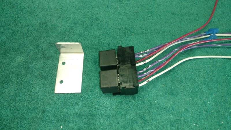

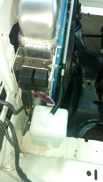

Fan relays and mount bracket.
![[Image: img_20190721_122952119-2194-jpg.810685]](https://www.forbbodiesonly.com/moparforum/attachments/img_20190721_122952119-2194-jpg.810685/)

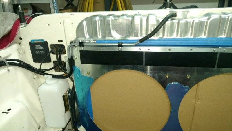

Here is bottle mounted - Im gonna re-do the hose/tube . Not diggin' the diagonal routing.
![[Image: img_20190724_211517006-2196-jpg.810686]](https://www.forbbodiesonly.com/moparforum/attachments/img_20190724_211517006-2196-jpg.810686/)
And the relays mounted - next up wiring. Got some wire terminals on order.

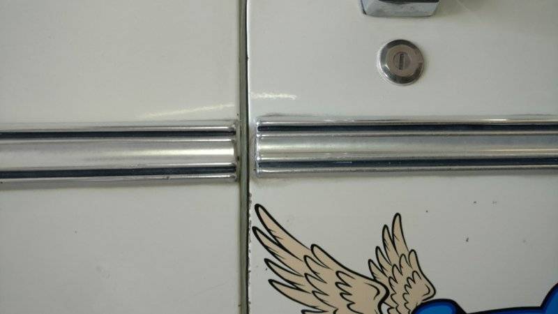

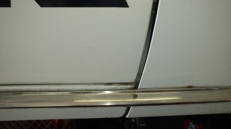

Got the passenger door adjusted, now the side trim actually lines up nice!
![[Image: img_20190807_212758950-jpg.814177]](https://www.forbbodiesonly.com/moparforum/attachments/img_20190807_212758950-jpg.814177/)
![[Image: img_20190807_212810863-jpg.814178]](https://www.forbbodiesonly.com/moparforum/attachments/img_20190807_212810863-jpg.814178/)

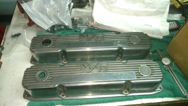

I also picked up these M/T valve covers, got a good price on 'em and they are polished.

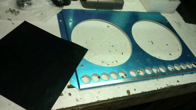

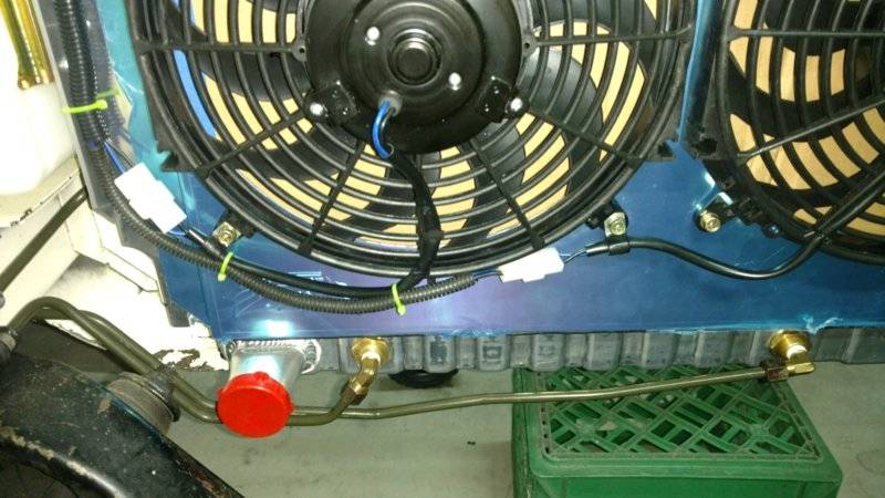

Back to the fans/shroud/overflow bottle/relays - I drilled 15 1-1/4 holes across the top of the shroud to allow more airflow thru the radiator when the car is moving. I bought some 1/16 rubber sheet to make flaps to cover the holes so the fans don't just suck air thru them instead of the core. It was a lot of work but I'm very happy with the result - hopefully it works.
![[Image: img_20190810_185345898-jpg.816510]](https://www.forbbodiesonly.com/moparforum/attachments/img_20190810_185345898-jpg.816510/)

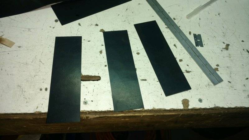

Rubber flaps cut out.

I also finished up the fan & relays wiring - the green zip ties are temporary.
![[Image: img_20190812_193712251-jpg.816513]](https://www.forbbodiesonly.com/moparforum/attachments/img_20190812_193712251-jpg.816513/)
![[Image: img_20190812_193729035-jpg.816514]](https://www.forbbodiesonly.com/moparforum/attachments/img_20190812_193729035-jpg.816514/)

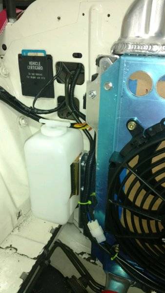

lastly - like I mentioned in an earlier post I re-routed the overflow bottle line/hose/tube. Looks much better now. Here you can also see how the rubber flaps look completed.

theman440 Wrote:Got some more parts in - DOTI manufacturing billet low mount alternator bracket and timing pointer. This is a nice piece.
![[Image: img_20190729_205703193-2193-jpg.811006]](https://www.forbbodiesonly.com/moparforum/attachments/img_20190729_205703193-2193-jpg.811006/)
My favorite valve covers.
What heads do you run? I machine spacers for those valve covers and o-ring the head to spacer. It works out real nice - never had any leak. But not all heads are the same. I'm in the process of making another run. Ordering material next week. I can make an extra set if you have any interest. Around $50 - 60 in material.
The other thing I do with those covers is machine the baffle standoffs some and safety wire the screws so that they can't fall out.
