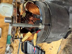

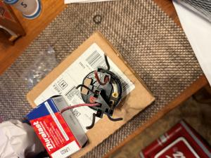

These are OEM colors, so anything under dash may be different or on the motor may be off due to age.  On the motor on the outside, you have 2 connectors, these are what park the blades down when you turn it off.  Green goes to pin D,top left on the on the top factory bulkhead connector, and continues green to the switch, which connects to the 2 bladed connector you see here.  The other outside one is brownish and connects to pin A on the opposite side of the connector.  That connects to pin A on the 4 wire connector on the switch.
The 2 wires inside are blue and red. Red connects to pin C on the bulkhead connector next to green, and connects to the other pin of the 2 wire connector with the green one.  The blue one goes to pin B on the bulkhead connector next to A and connects to pin B on the 4 blade connector.  The other wires on the switch are for the dash lights and power to the switch.
