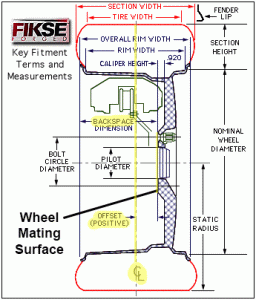

Hello everyone! I am new here and just got a 1968 Coronet convertible.
Need some help please. I am going to be putting Cragar 61C Series S/S Super Sport on my 1968 Dodge Coronet. 15x7 on the front and 15x8 on the rear. My question is backspacing - 4.25 or 4.75 & offset - -6.00 or +6.00? Don not really have any idea on backspacing & offset.
Wheels I am thinking about front 225/ 60 R15    rear  245/ 60  R15.
Any help would be great!
Thank you
RE: wheels and tires - 67r/t4speeder - 12-19-24
Welcome..
This might help.
