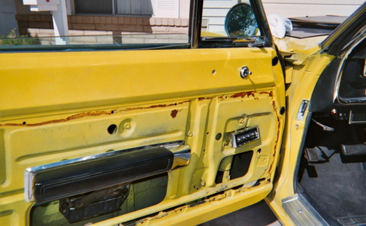

In this picture, you can see my 1966 Coronet 500's interior door sheet metal with the drivers side door panel removed. The door panel mounting holes are the ones in line where you see the thin line of brown adhesive that holds the plastic moisture guard sheet in place that is located between the sheet metal and the backside of the door panel. (moisture guard plastic is not in place in this picture) These holes are where the wire clips on the backside of the door panel pushes through and expand to hold the door panel in place.

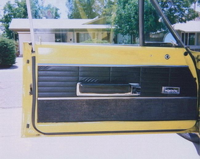

This picture shows the door panel in place and there are no attaching screws in place like the ones you're asking about.
[Image: 1966Coronet500-originaldriversdoorpanela...g~original]

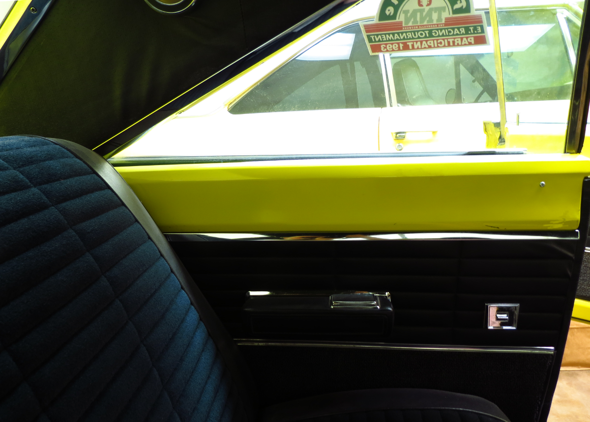

This picture shows the rear door panel in place.
[Image: My%201966%20Coronet%20500%20-%20Rear%20D...g~original]

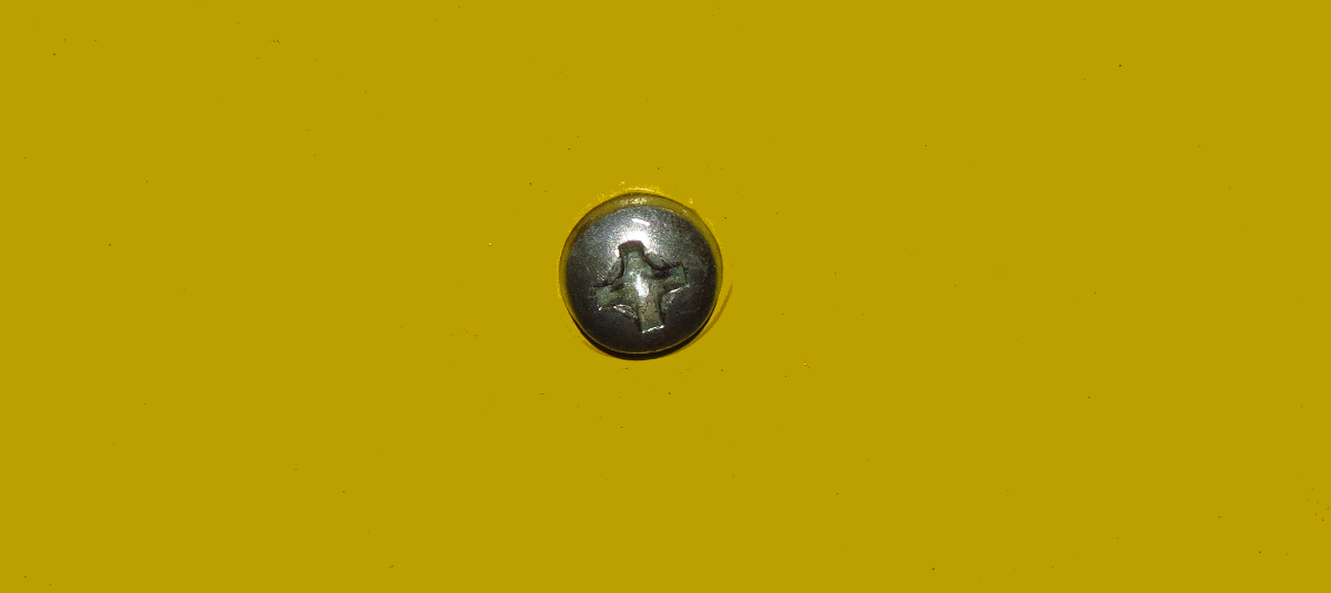

A close up picture of the screw that holds the rear removable quarter panel sheet metal panel in place.
