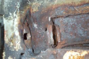

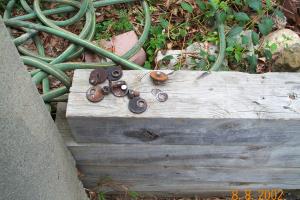

But you haven't lived til  you had to do this to remove upper control arms..
Or found this once out...
