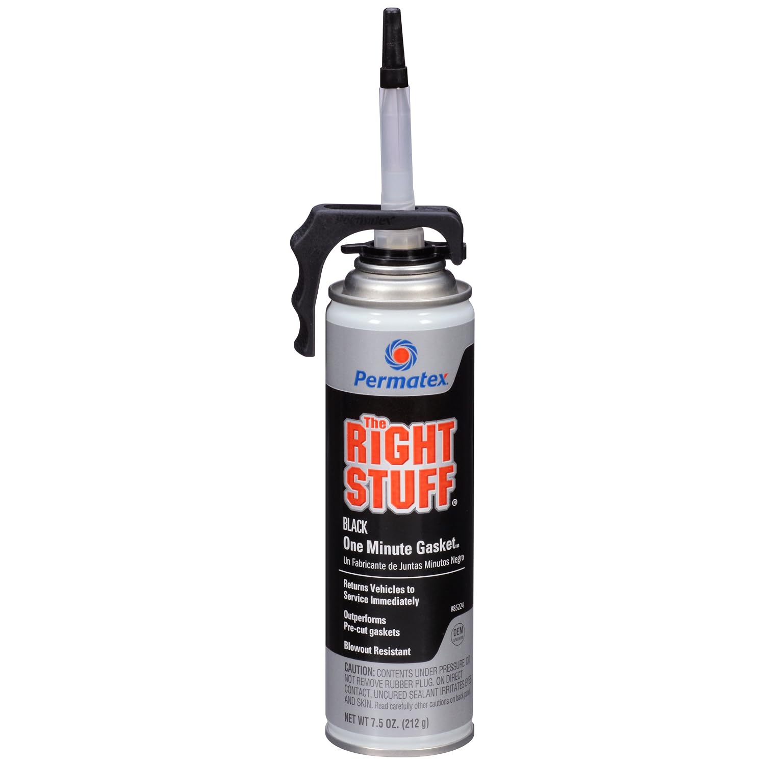

Andy, what do you use for sealer on the splines?
11-26-17, 02:26 PM
I keep coming up with a #5851 National also if that helps
11-26-17, 02:28 PM
ws27 Wrote:Andy, what do you use for sealer on the splines?
Gotta be super clean and dry and it sticks and seals real well.11-26-17, 04:13 PM
