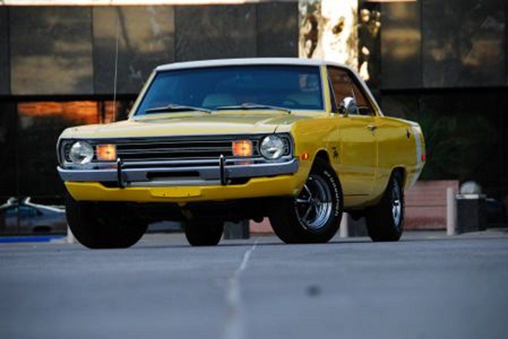

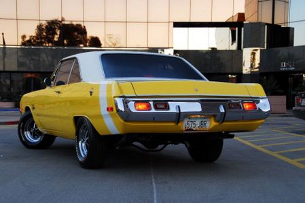

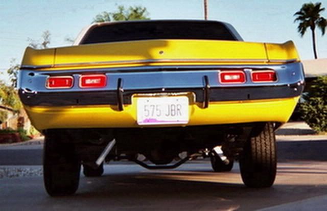

On my sons 1972 Dart Swinger, I went with a remanufactured short block from Chrysler and added a factory cast 340 intake manifold with an adapter for the Holley 600 four barrel carb and also added a set of the 340 exhaust manifolds. We rebuilt the cars original cylinder heads and topped off the engine with one of the Mopar Performance chrome 340 air cleaner assemblies, I also installed one of the Mopar Performance 90 degree oil filter adapters so that we can run the larger capacity oil filters and I also added one of the small block high performance Mopar Performance fuel pumps.
Regarding the transmission, I had the cars original 904 completely rebuilt and added a nice shift kit and a new factory spec torque converter and a Mopar Performance deep transmission oil pan and filter kit.
This car still runs it's original 7.5 rear axle assembly without a Sure-Grip unit and a 2.76 gear ratio, so it's not a hot rod by any means, but it IS a very nice overall engine, transmission and suspension package that has all of it's parts working well together.
My son lives in California now and the car stays here in my garage, so he doesn't drive it on a daily basis any more, but while he was using it as a daily driver, he absolutely loved the car for it's reliability, handling and smooth well running 318 that also sounds great with it's duel exhaust system.
It sounds as if your friend isn't looking for impressive E.T.'s on the drag strip, but is looking for a well rounded power and handling package that won't need daily maintenance to keep it happy, so please don't sell that 318 and 904 short, as if done correctly, that combo could make him very happy.
