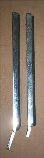

Below is the information that will give you the correct factory part numbers for the quarter window glass front frame weatherstrips that you're asking about. This information is taken from the thread that I wrote for all DCR members. This thread is titled "1966 & 1967 B-Body Window Glass & Weatherstrip Interchange Guide" and is located in the "Paint/Body/Interior Archive" forum.
Here is the link to that complete thread: http://www.dodgecoronet.com/forum/showth...ange-Guide
There is a wealth of information in that thread including helpful diagrams from the 1966 and 1967 Factory Parts Books that should answer any questions you might have regarding all of the window glass and it's related weatherstripping for all of the 1966 and 1967 Dodge and Plymouth B-Body models.
PLEASE NOTE! The weatherstrips that you are looking for have different factory part number in the 1966 and 1967 Factory Parts Books as shown below, but I believe that is because the front frame parts that these weatherstrips fit into are different and while the front frame parts are NOT interchangeable between the 1966 and 1967 hardtop models, it looks like they are close enough that the aftermarket suppliers have made one weatherstrip part that will fit both model years.
I've posted a picture below showing a 1966 hardtop quarter window front frame part located on the left side of the picture and the same part that was used on the 1967 hardtops on the right side of the picture so that you can see the difference. If you happen to purchase a set of n.o.s. weaterstrips, then the part numbers are important, but if you purchase them from an aftermarket supplier, then factory part numbers aren't important as they will be listed for use on both 1966 and 1967 hardtop and convertible models.
As you can see, the 1966 frame piece uses two rivets to mount it into the car on the bottom of the part while the 1967 frame piece is a press fit to the quarter window glass design and has no rivets at the bottom of the part.
![[Image: 100_1382.jpg~original]](http://i146.photobucket.com/albums/r248/thebankerstoy/Mopar%20Parts%20-%20Factory%20NOS%20-%20New%20-%20Used/100_1382.jpg~original)
Many of the Mopar aftermarket parts suppliers sell the quarter window front frame weatherstrips, but they do not offer new reproduction stainless front frame parts, so you will need to install the new weatherstrips into your cars existing frame parts. Chrysler never sold the stainless front frame parts separately either, only the weatherstrips, so if you needed new front frame parts, you had to purchase the complete quarter window glass assembly.

I hope this information helps you.

06-14-15, 10:18 PM
I have nothing else to say but THANKS! That's exactly what I was looking for. Didn't know R/T had those. Just ordered some stuff from them last week too.
06-14-15, 11:42 PM
You're very welcome! I'm always happy to help out a fellow 1966 or 1967 Coronet owner! I've been dealing with Tom Race at R/T Specialties since he was located here in the Phoenix AZ area many years ago and have always found his parts to be nothing but the highest quality!
