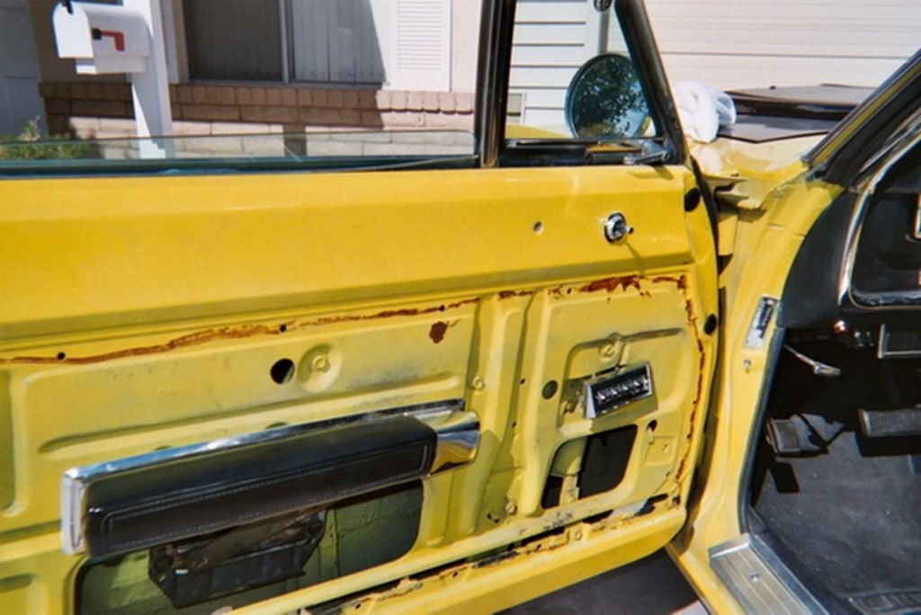

You didn't mention if you had this issue at your master 4 gang switch on the drivers door, or the single gang switch at the quarter window, but which ever switch it is, I'd start planning on looking at that switch to make sure it's contacts are clean where the switch plugs into the wiring harness connector and check to see if all of the switch pins are in good condition and tight. Also check to see if you have any exposed wiring that could be shorting out on the inner door, or inner quarter panel sheet metal where the harness passes through to the switch.

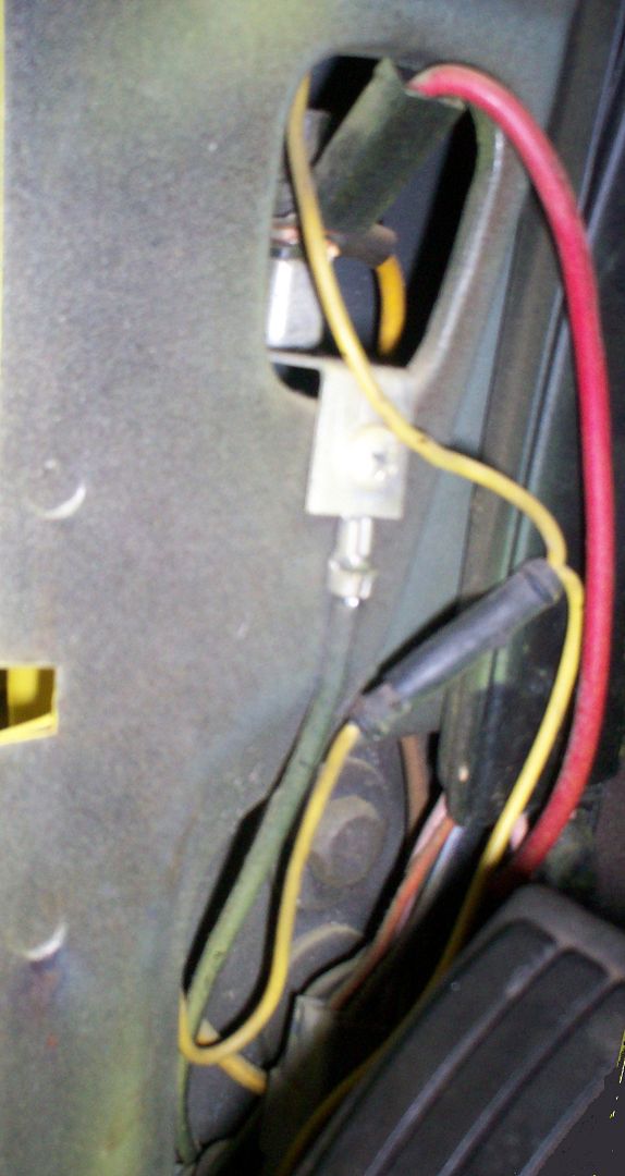

The other location where you will find connectors for the power window wiring harness is behind the drivers side kick panel.
![[Image: My1966Coronet500-powerwindowwiringbehind...panel3.jpg]](http://i146.photobucket.com/albums/r248/thebankerstoy/My%201966%20Dodge%20Coronet%20500%202%20door%20hardtop/My1966Coronet500-powerwindowwiringbehinddriverssidekickpanel3.jpg)
If the switch is getting excessively warm, it's building up resistance and will eventually cause the switch to fail and as I've mentioned in my previous posts, there are no aftermarket parts to repair the '66, '67 and '68 switches.

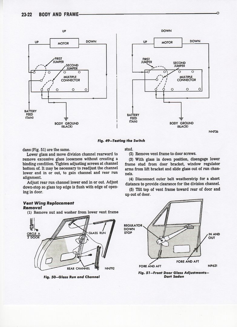

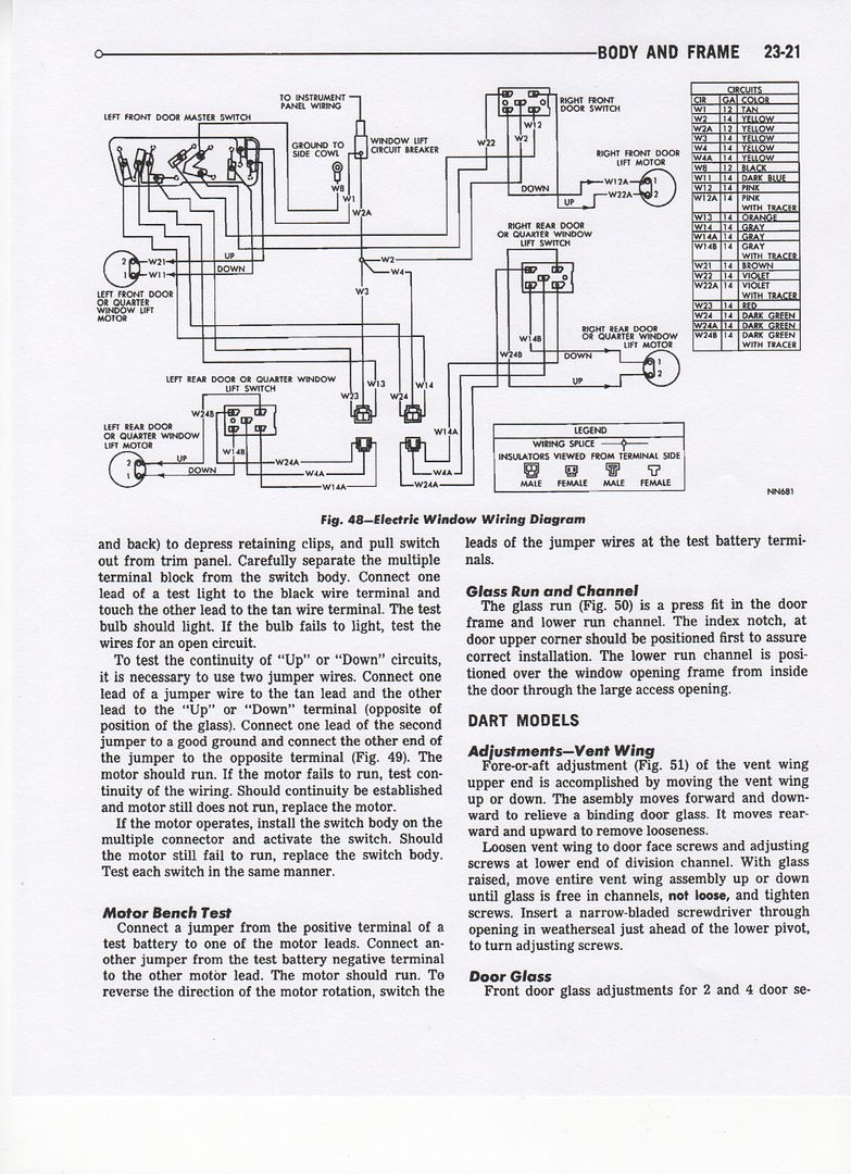

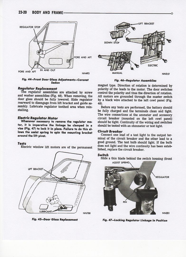

Here are a few pages from my 1967 Factory Service Manual which talks about testing the power window motors and switches as well as showing the wiring diagram for the power window system.
