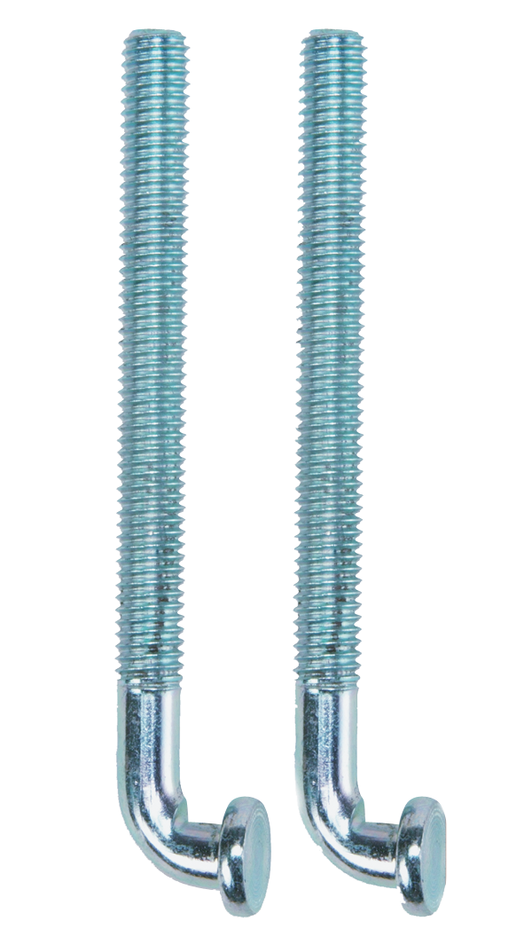

Below is the current Year One listing on their web site for the fuel tank support strap mounting studs. This is the only stud that they sell, which is only correct for the 1968-69 model year cars. They advertise their studs as being correct for use on 1966 models, but not 1967 models which both use the same style "?" question mark shaped stud, not the "J" shaped stud, so they are incorrect for the 1966 model year cars and I'm not sure if they are correct regarding the 1970 B-Body cars which use a different part number for their fuel strap mounting stud than all of the 1966, 1967, 1968 and 1969 model year cars.
1966-74 A/B/E-Body »
Air/Fuel »
Tank - Mounting Straps / Hardware »
Studs / Nuts (back to previous step) »
[URL="https://s3.amazonaws.com/gearbox-yearone-com/part-images/f0_f9/f986p.png"]
![[Image: f986p.png?height=450&width=600]](https://s3.amazonaws.com/gearbox-yearone-com/part-images/f0_f9/f986p.png?height=450&width=600)
+ Click to Enlarge
[/URL] [B]Part Number: F986P[/B]
[B]Fuel tank strap stud pair, 1966 A-and B-body, 1968-1974 A-, B- and C-body, and 1971-1974 E-body models. [/B]
Fuel rank strap studs.
NOTE: 1966-1967 cars use only one tank strap. On these cars only one stud is required. Please check your car before ordering.
